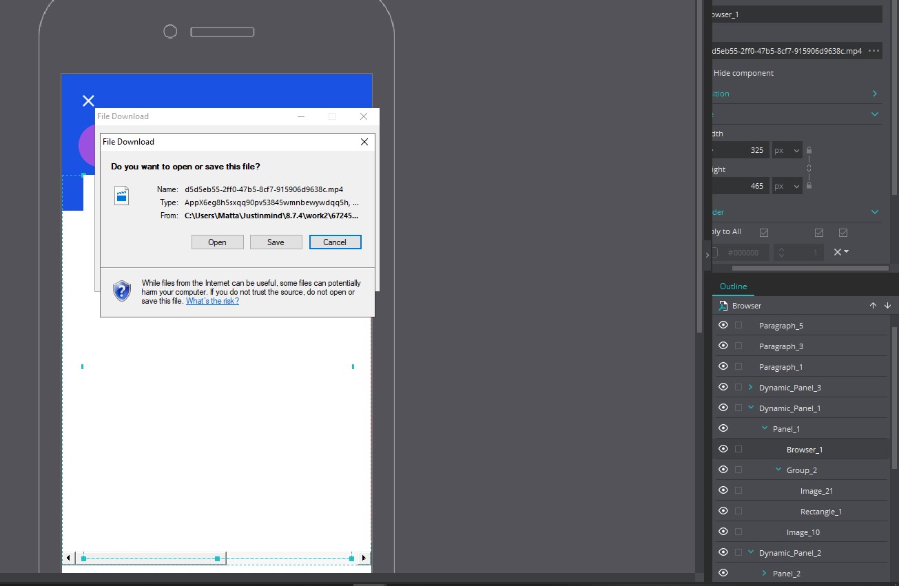

I'm having trouble adding videos to my prototype. As i understand it, to add videos from my computer I first use the Document Special component, and then select the video file under "file" in the properties tab. However strangely every time I attempt to upload a video, instead of displaying the video in the document box, a notification pops up asking if I want to download or save the video file? .
After looking at this further, here's what you should do:
Use an mp4 file in the document widget. You'll see a dialog appear to download or save the video, but just click 'cancel'. When you simulate, the video should appear correctly.

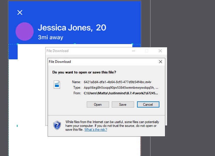

You'll need to convert the video to another format - m4v should work.
It appears to do the same with m4v files.
Thanks for the info - it looks like it might be different for Windows. I'll ask our team which format should work best on Windows and get back to you soon.

Yeah, we realize this isn't ideal. Here's another workaround that's pretty simple you can try. It shouldn't show any dialogs:
1. Drag an HTML widget onto the Canvas.
2. In the Properties palette where it lists the html, paste the following, replacing the location of the file with your video's path, and the videoname with your video's title. Note that this will only work for your local simulation - the video won't work if the prototype is shared to your online account.
