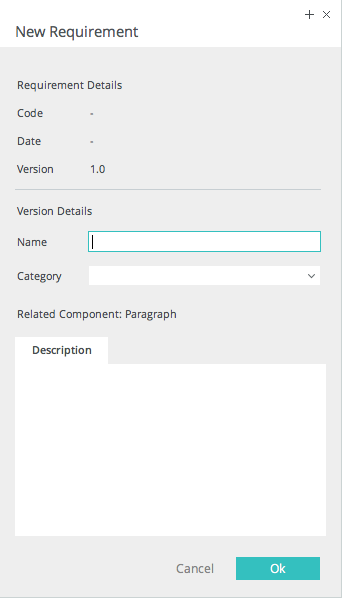

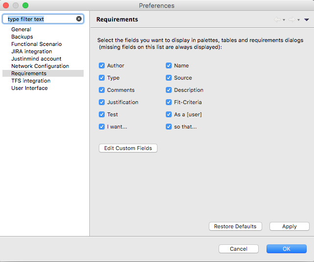

To follow the User Story format, I wanted to add custom fields to Requirements in Preferences > Requirements > [Edit Custom Fields]. I'm expecting them to show up when I add a requirement to some object, but it looks exactly the same as before.
In fact, I just now turned off ALL the requirements fields, and the requirements modal hasn't changed at all.

Apologies for any confusion. Editing the requirements fields in Justinmind preferences (your first screenshot) only affects new prototypes, not the one you're currently working on. To edit your current prototype's requirement fields, go to File -> Requirements configuration and change the fields there.
