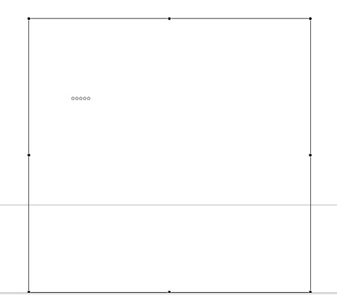

Sorry, maybe I was unclear. This is what I did:
1. Created 100 x 100 pixel image widget.
2. Click "Add Image" link.
3. Navigated to image (image is about 50 x 20).
Image imports but much smaller than actual size. In fact, I can barely see it.
4. Click "Original Image Size" (not sure why I should have to click this. It should be default.
Image is correct size, but now image widget is 1000 x 1000 pixels so it fills up my entire screen. I guess that I could leave it that size, but it gets in the way of other widgets. Using the crop tool has the same result.
My goal is an image widget that is only a little bigger than the actual image, so it does not get in the way of the other images. I have not worked with software that has this behavior.
Getting back to the original problem (Adding image to screen background), I am beginning to think the problem is with TIFF images. When I try to import other file formats, it seems to work fine. When I click the "Add Image" link, the file types listed at the bottom of the Open dialog (Mac) clearly mentions .tiff.
Not sure whether that is a Justinmind setting or just a Mac default. Are TIFF images supported by Justinmind?
As for the small image problem, I figured out how to create a screen capture in another file format, so see attached (the view is actual size). b89e9a7f04ca90641e8dc91f5f3bb5e4
