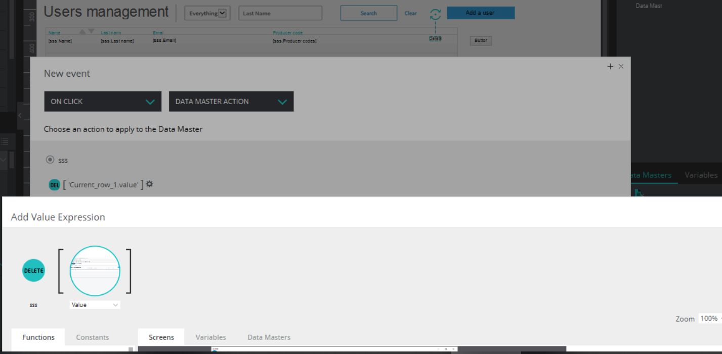

This is about adding a row to a data list. What I need is a confirmation button when a user wants to delete a row from the data list. I can do the buttton, I can do the deleting. What I can't do is link the two.
What do you mean by 'link the two' in this case?

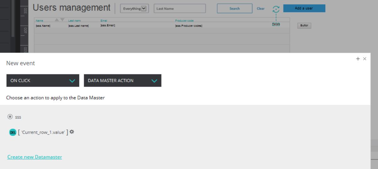

I mean that I can create a datalist, I can add a column to delete this or that row, and I can add a datalist-event to actually delete that row - please see deleteElementsDataListConfirmation.JPG
I can also create a confirmation message - please see deleteElementsDataList.JPG
But what I want to do is, user clicks on "delete" on a particular row and sees the pop message asking him to confirm if he does want to delete it. Only when the user confirms he does want to delete it, would the data entry actually be deleted.
Thanks for the info - I see what you are looking for now. Check out the attached example. Here's what it does:
For the delete text:
  1. Created an "On Click" + "Show" event that shows a confirmation dialog.
  2. Created an "On Click " + "Set Value" event that gives the confirmation dialog the value of the Current_Row (clicked row), so you'll know which row you've selected.
  3. Created a Variable that stores the value of the clicked row. Then, we added an "On Click " + "Set Value" event that gives the variable the value of the clicked row.
For the confirmation dialog:
  1. On the 'Yes' button, created an "On Click " + "Data Master Action - delete" event that uses the Variable's value (which is storing Current_Row_1) as the value to delete.
  2. On the 'Cancel' button, "On Click" + "Hide", hiding the dialog.
