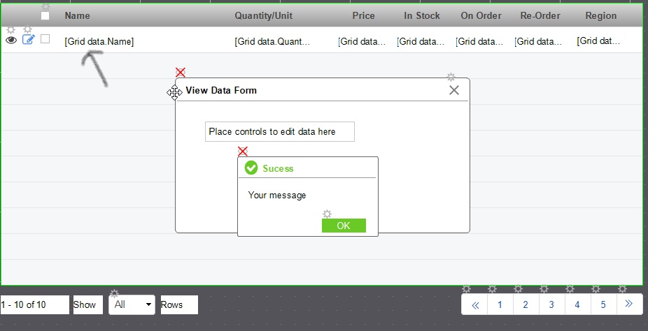

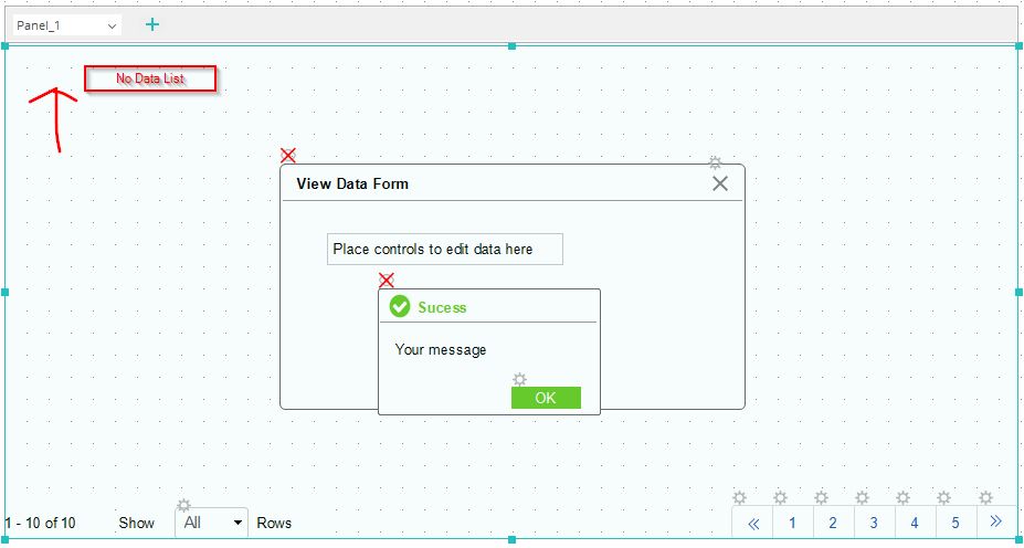

I am trying to build a widget for grid/table control which can be reused by my team while building prototypes. The grid/table control is essentially a dynamic data list with some additional functionalities and buttons. I grouped all the controls in a dynamic panel and then created a widget. But the widget does not include the data list which is crucial part of the overall widget. I can add to a master tough and use it within the project.
Is there a way to create widget using data list or share the master that I have created with my team so that they can use it as a control in their own projects?

I've just realised that by oversight we didn't reply your inquiry. Unfortunately, your idea cannot be accomplished as there is no possibility to create widgets that contain data lists/data grids as they are associated to a Data Master (DM can't be included into Widgets)
Sorry for the inconvenience and our late response.
