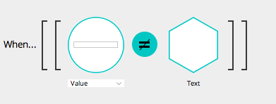

Hi, I have several form fields on my screen and want to add a condition that the active button isn't shown until all the fields are filled out. How can I do this? I can't see how I can set a condition saying 'last field ≠ empty' Do you have a visual example of these conditions in the conditions panel?
Hi Rosie,
The condition actually will be 'last field ≠ '

Regarding your specific question on how to achieve something like 'last field ≠ empty', Danielle's screenshot shows it. I don't know if it's required, but in order to get it to look like the screenshot, once you've dragged up the input and the "≠" sign and get the dotted circle that says "Double click to edit or drag & drop a component", just double click the circle than tab out of it.
