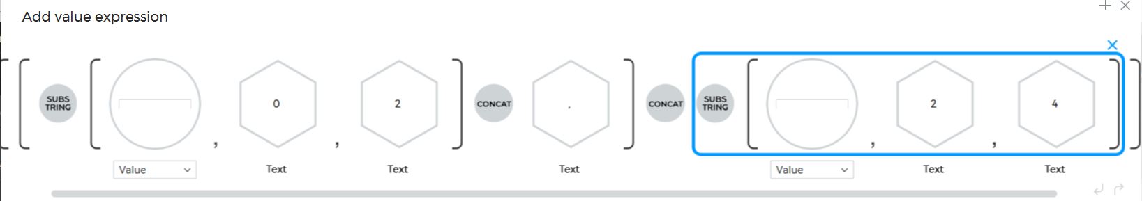

I wanted to know if it is possible to design interaction, where a user is adding numbers and when focus out, last two digits go in decimal and 'coma' comes after first three digits from decimal from right.
Hello, in this case, you could use the event "on fucus out" + "set value to an element" with calculated value and in the expression builder, the "substring" function to separate the output, and then use the "concat" function to insert the commas and periods. I attach an image of an example in which you can separate a 4-digit number with a comma.
Let me know how it went.
