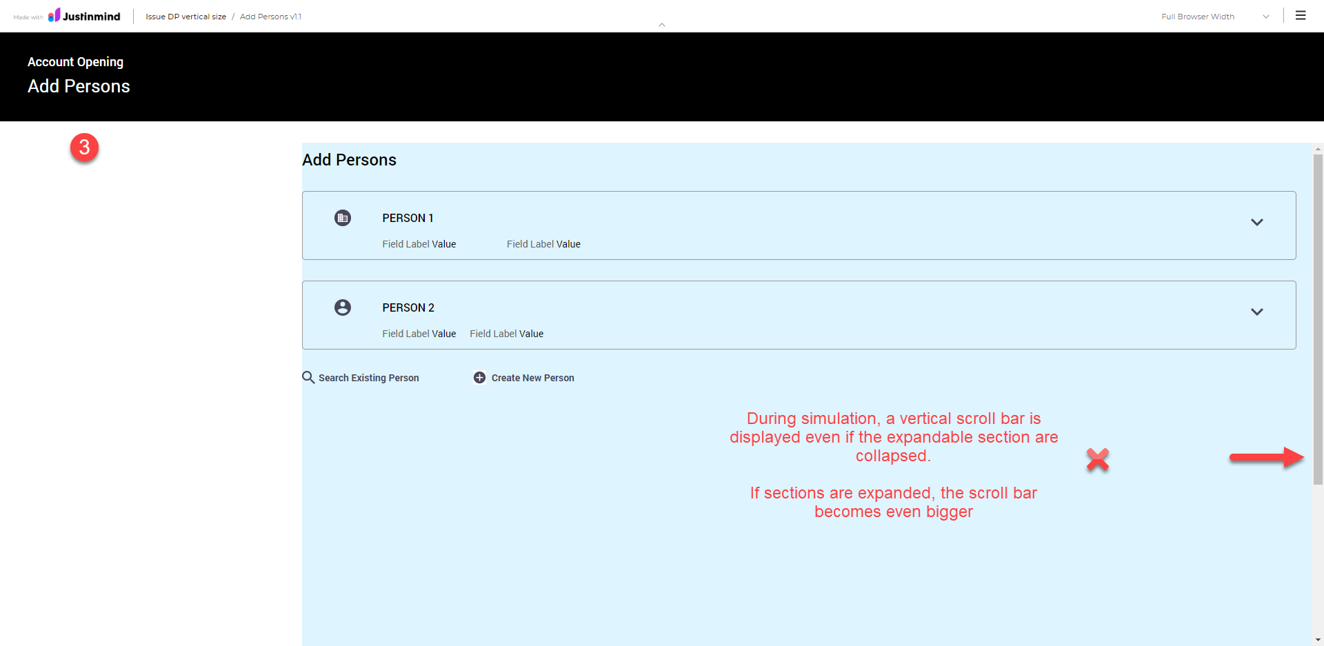

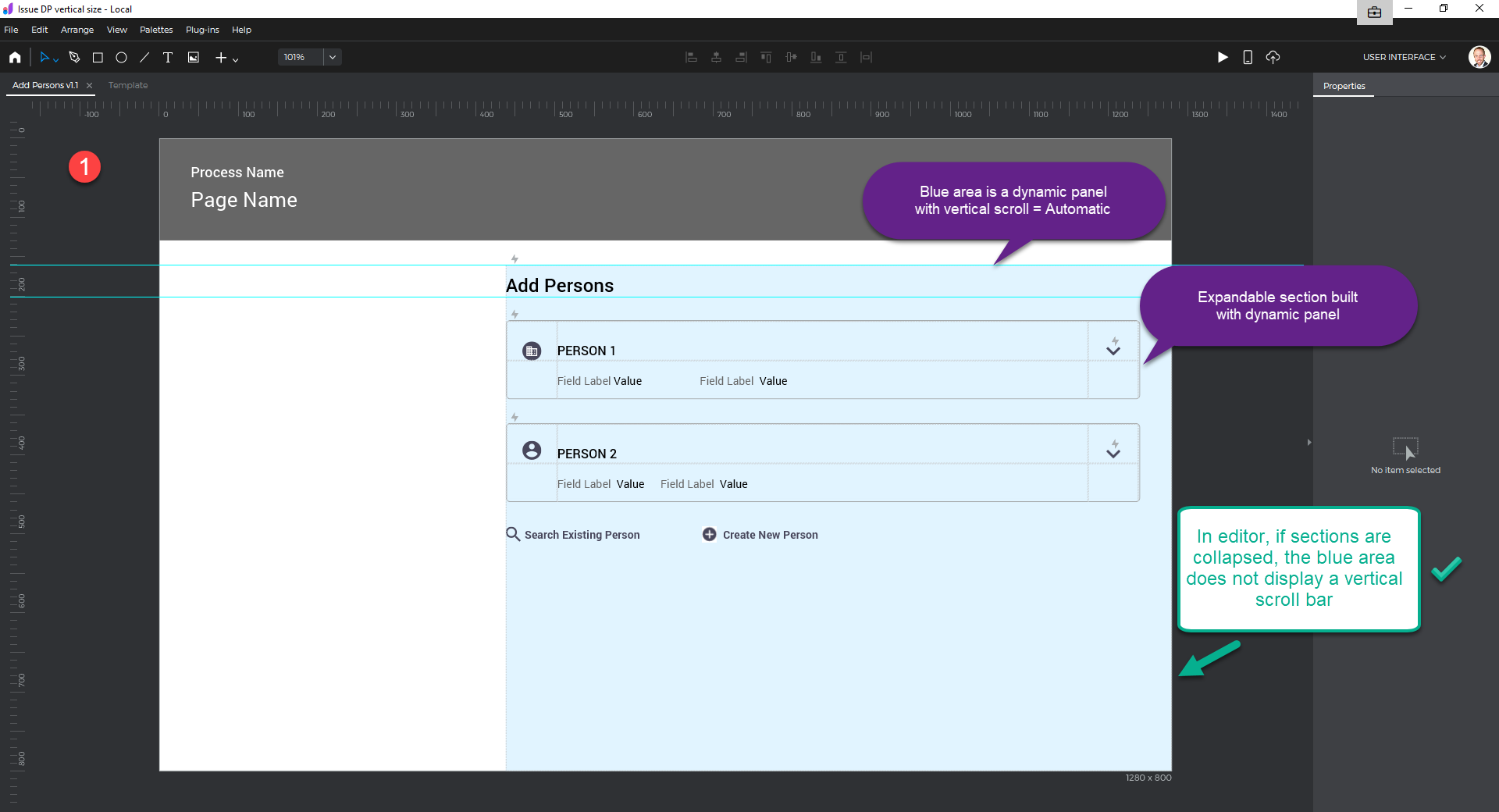

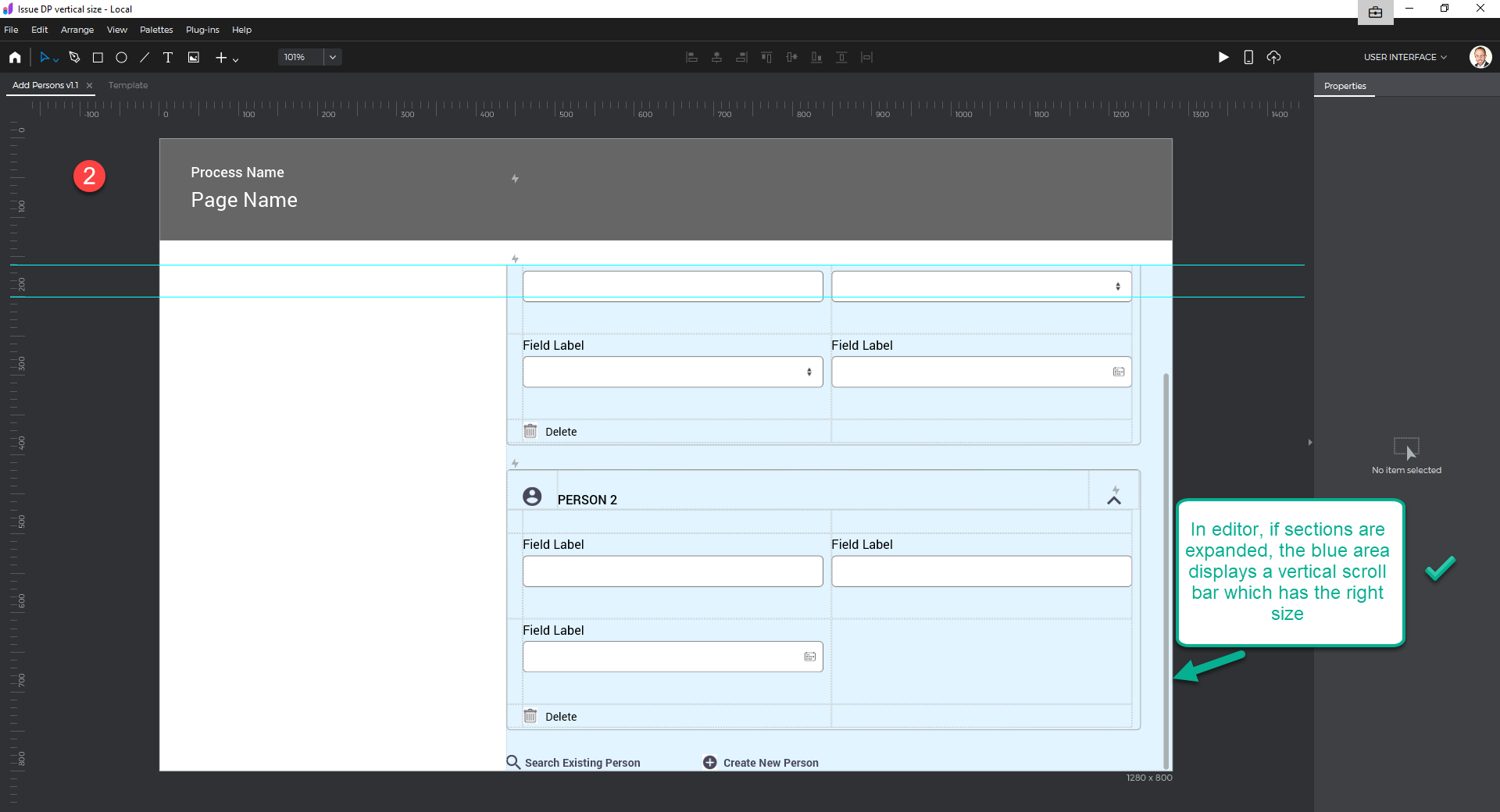

I am experiencing an issue with the height of my dynamic panel during the simulation which results in the display of a huge vertical scroll bar whilst there is no need for it.
The issue is explained in the 3 screenshots attached.
I believe the issue occurs only when dynamic panel are included within other dynamic panel.
