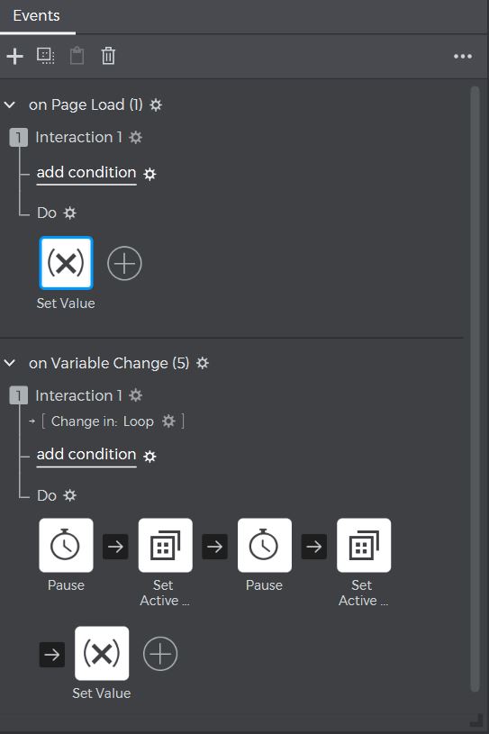

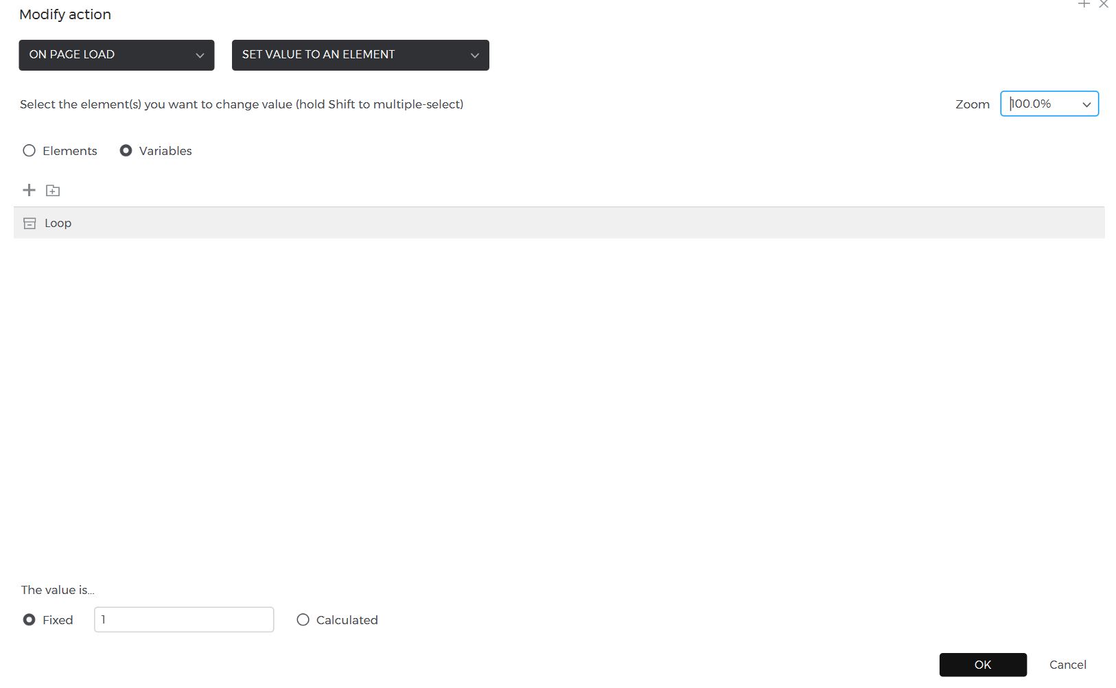

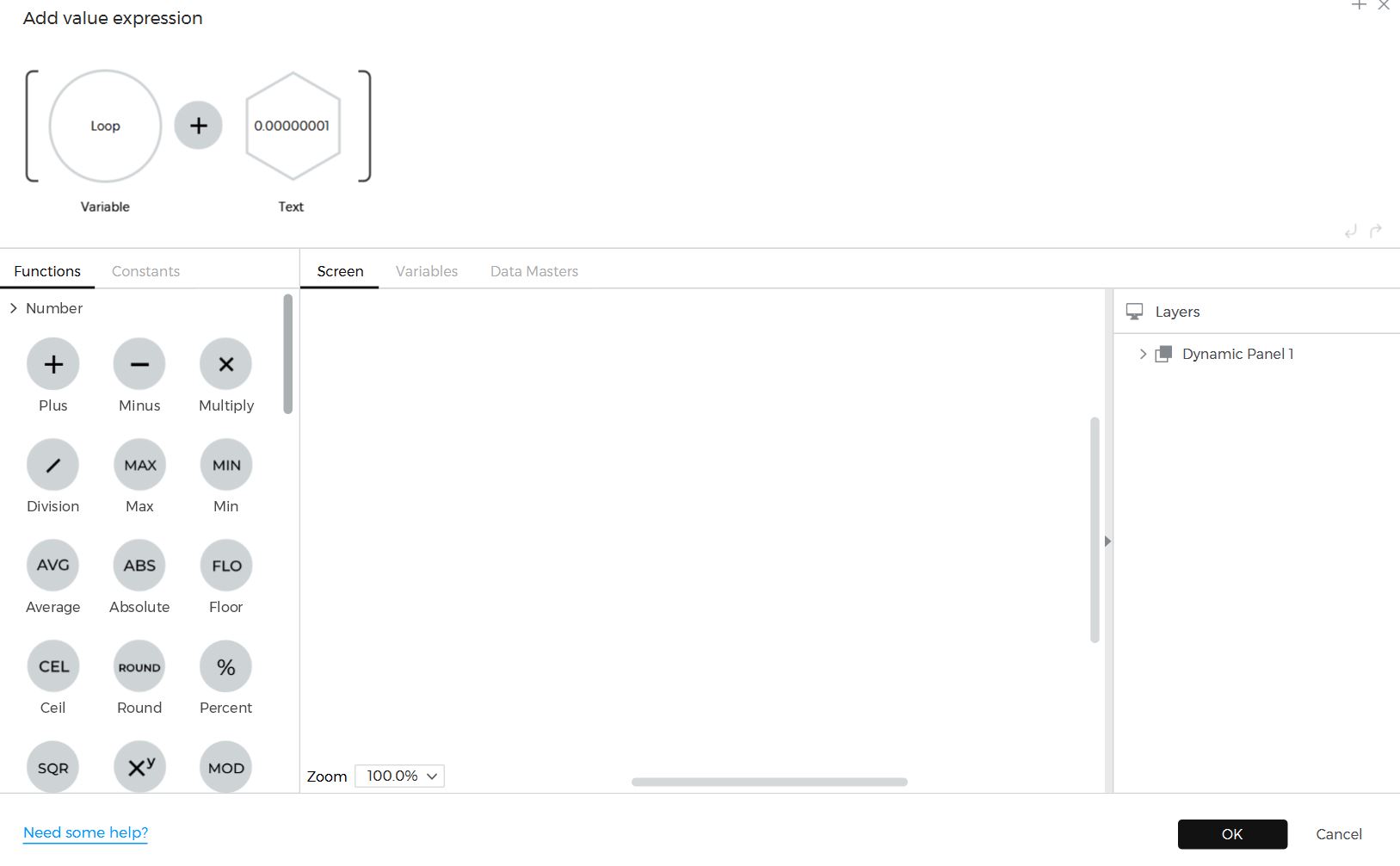

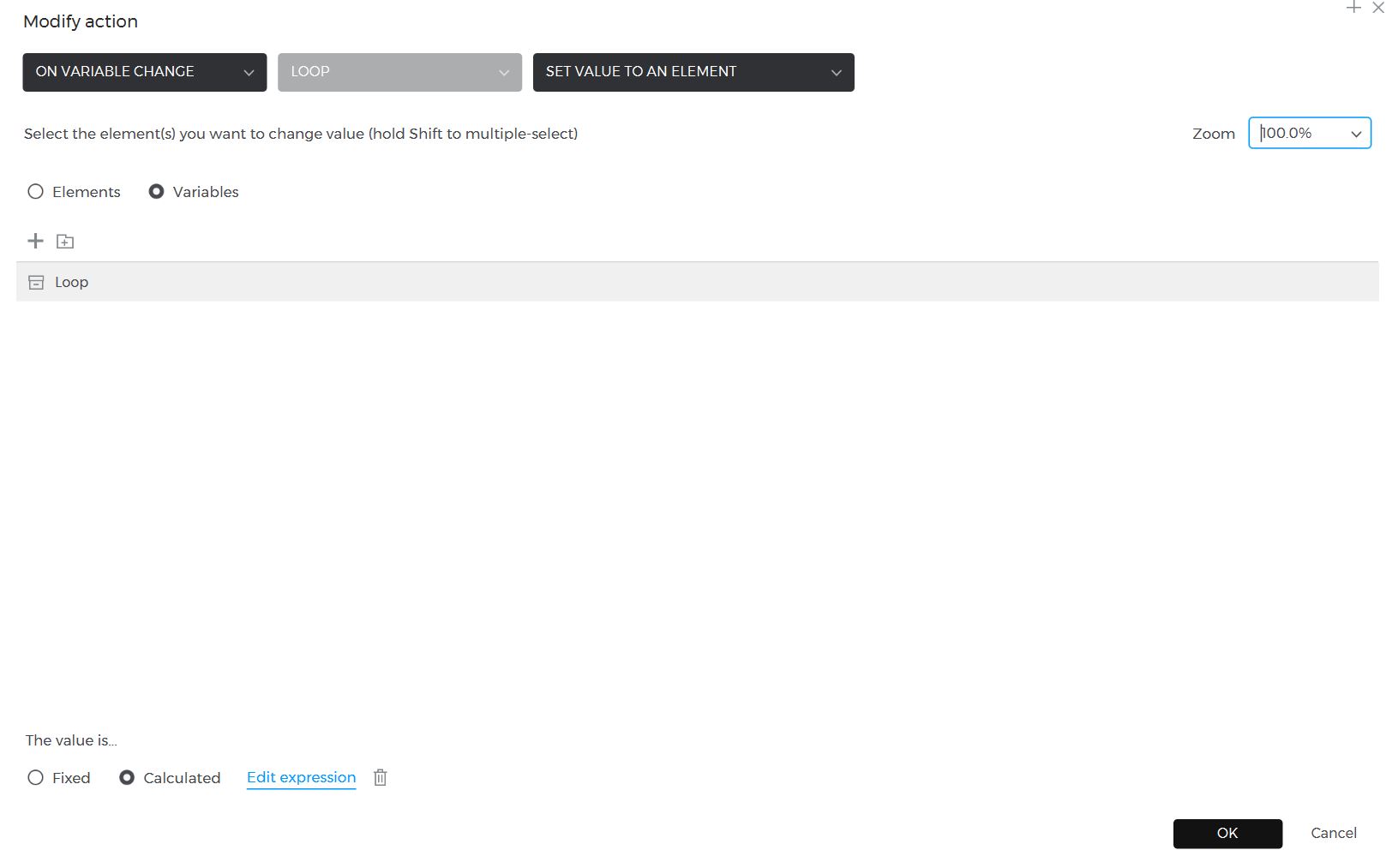

Hello, it is possible to make loops with panels, I am attaching an example: In the panel, you will be able to see the event, where an "on page load" variable was created and then in "on variable change" the panel pause and "set avctive panel" events , to finish in the same sequence an event of "set value to an element" with a calculated value where the variable will be dragged to the first field and the sum function, in the last field a number that will make possible the variation of the fixed value of the variable giving the loop effect, the lower the number, the longer the loop time.

Thank you very much it worked!!! I've been stuck in this for days thank you very much!!
You are welcome! let us know if we can help you with anything else.
