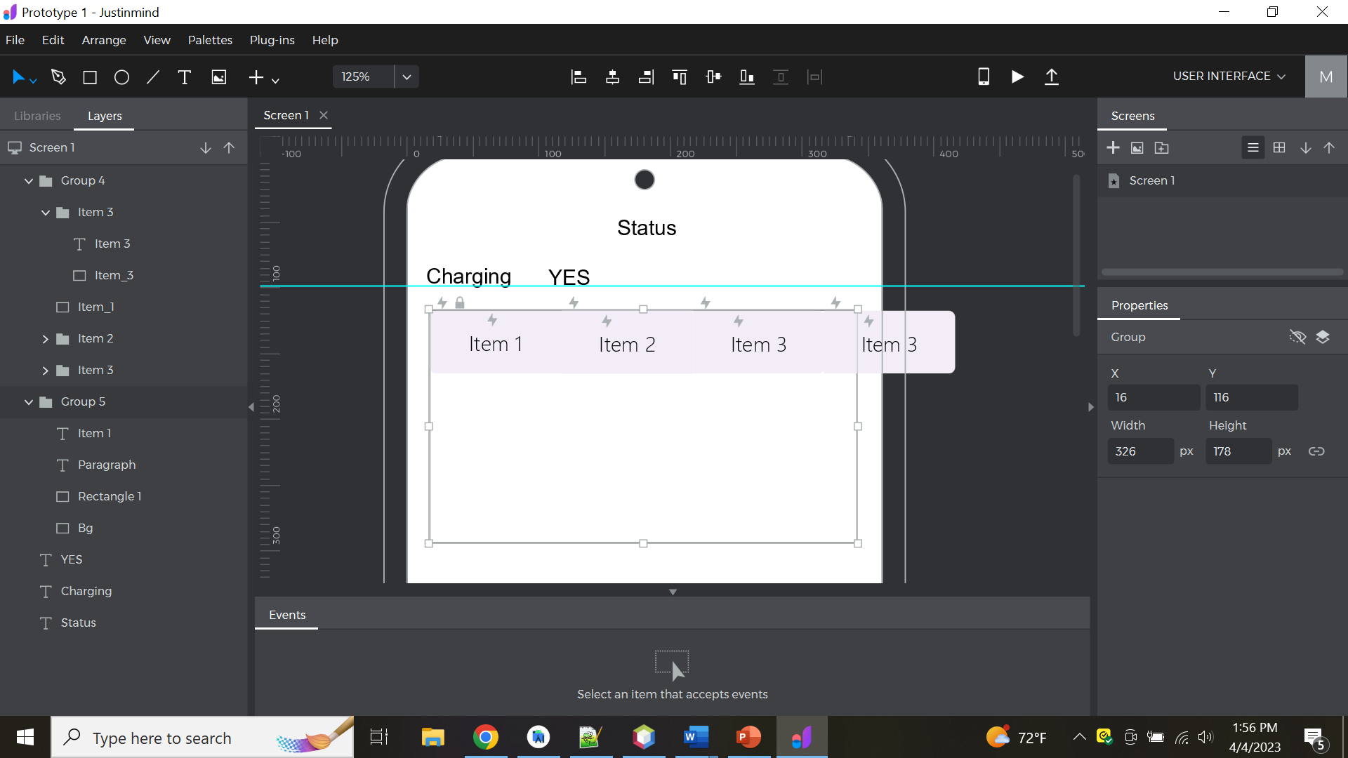

I've gone through much of the documentation and many of the tutorials, but I am not seeing how to access the raw CSS, HTML etc. The issue is that I need to create a horizontal menu inside of a rectangle element and hide any menu items not inside the rectangle (please see the attached image. If I were doing this by hand, I would use something like "overflow: hidden" with CSS on the containing rectangle.

Hello, You can create your menu inside a dynamic panel, this will correct the image you sent, remember you can hide elements from the properties palette, by clicking on the eye icon.
I leave you more information about the menu: https://www.justinmind.com/support/dynamic-panels/
let me know if this is what you need.

Hi, you're welcome, let us know if the information was useful and if we can help you with anything else.
Yes, it was very useful. Thanks again!
