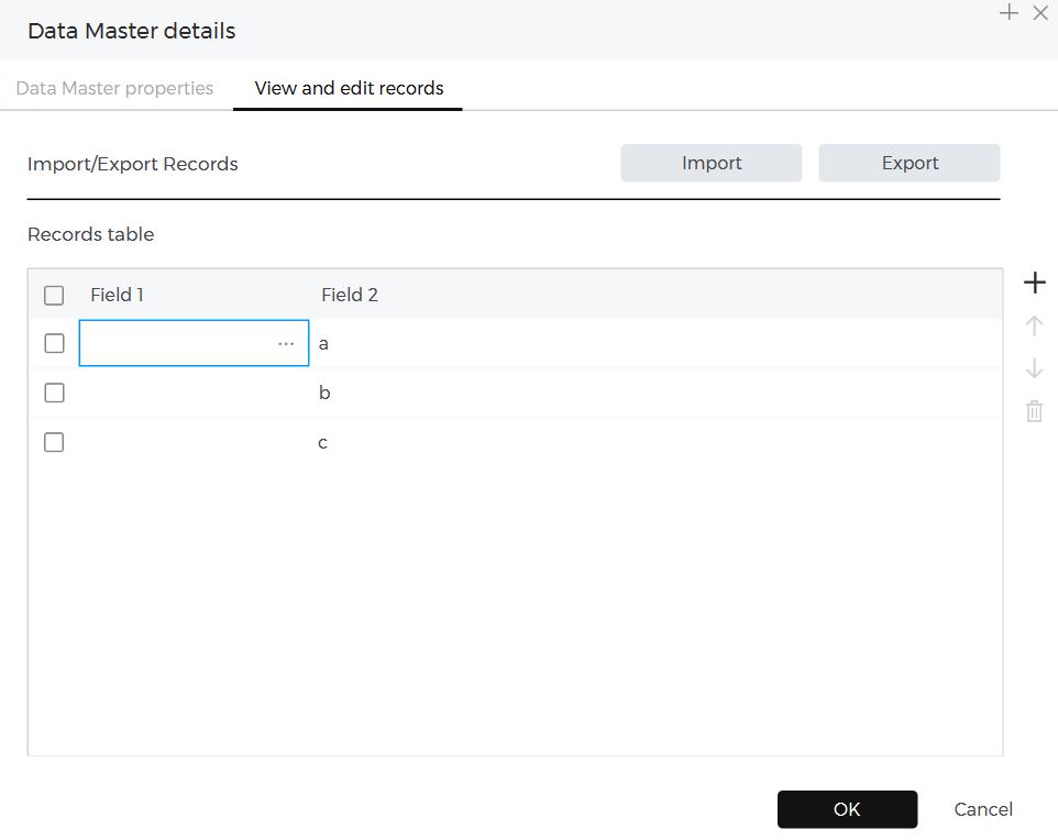

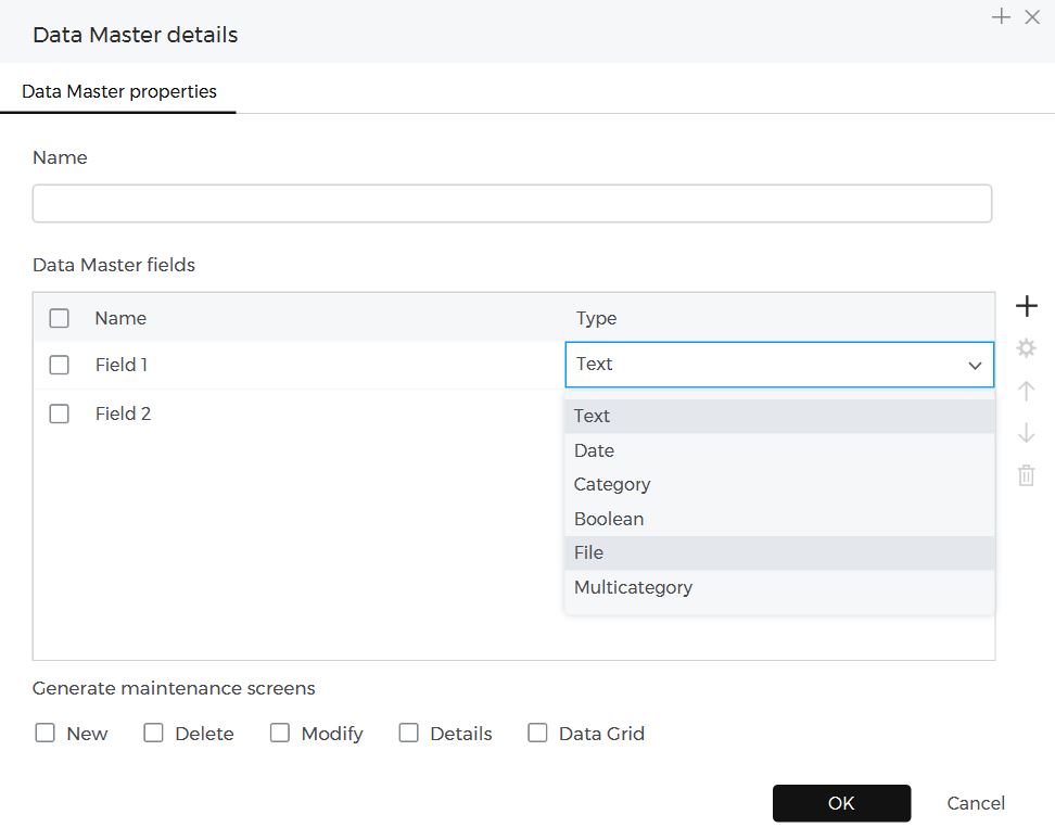

Uhhhhh I have another question how do you add the images on the entries because the tutorial I watched on YT did not state anything on how to just like the one in the pic 82dc2c9a5920f15d2e081c3942572391
Hello Clark, when you create your data master, select "file" for the type of the field that will contain the images, once the data master is created, from view and edit records, associate the images in each field, I attach screenshots.
Regards.
