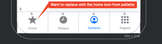

This is just an example. I want to replace the icon on all of these tabs but save the actions attributed to them.

Thanks for trying to help. I'm using the default component for a 4 button tab bar provided by the software. I should be able to click on the star for example, and change it to another icon from the icons pallets. A simple function available in every other mockup software I've used.

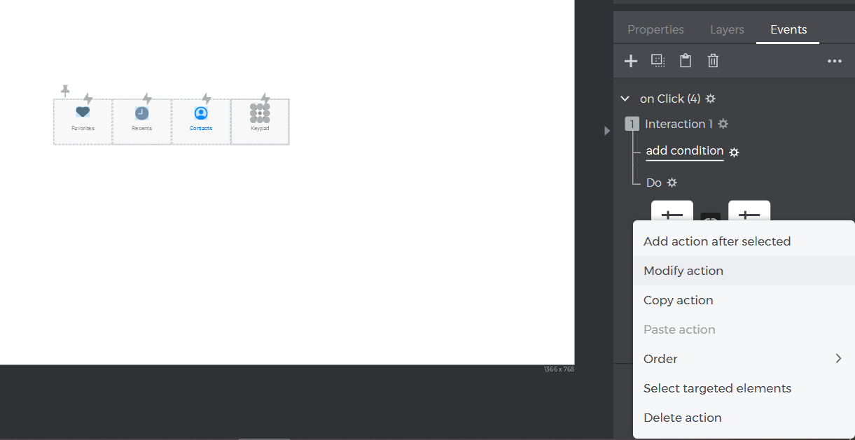

Hello Marc, I am attaching an example, below I detail the steps I followed:
Select the icon you want to change and go to the events palette.
Use the copy button to copy all events.
Replace the image and from the events palette paste the previously copied events.

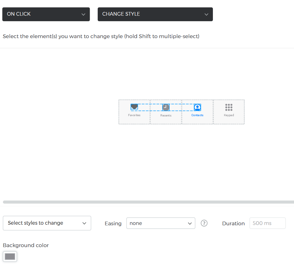

Once you have replaced the images and pasted the events, go to a different icon and make sure you redirect the last event which is the one that gives you the style reset effect (I attached images of this last step).

Hi, sorry for the misunderstanding, once you copy the events from the events palette, you can delete the icon and put a new one and paste the copied events.
