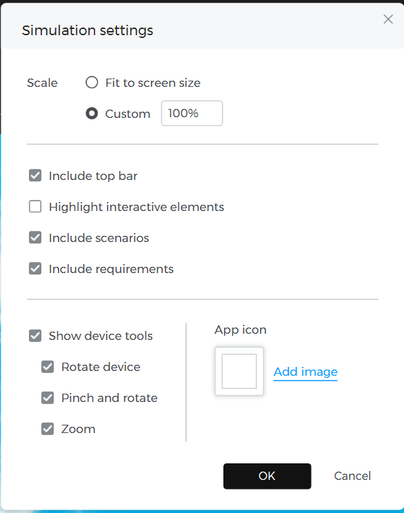

Hello, you can adjust the simulation settings from: File -> Simulation -> Settings:
uncheck highlight interactive elements.
I attach an image.
let me know if it worked for you.
That took care of it - thank you.
