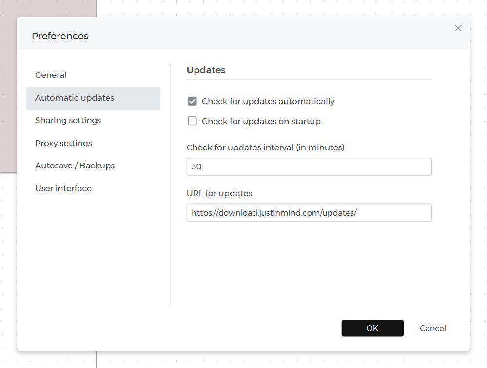

Hi Andrew, could you go to File -> Preferences -> Automatic Updates and take a screenshot of the configuration?
Attached
Hello Andrew, could you go to Help -> Sign out and log in again.
Let me know the result.
That seems to have resolved the problem.
Great! Let us know if we can help you with anything else.
