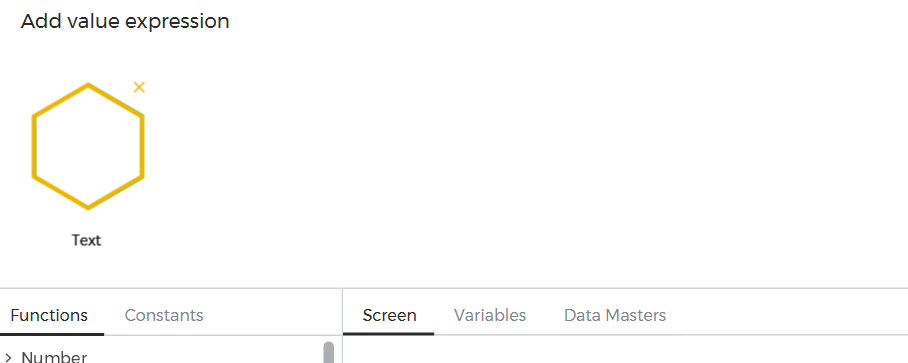

Hello, in this case I could add an event on the screen, on page load, set the value to an element, select the data list and in the calculated value, add a constant text empty in the expression.
let me know how it went.
