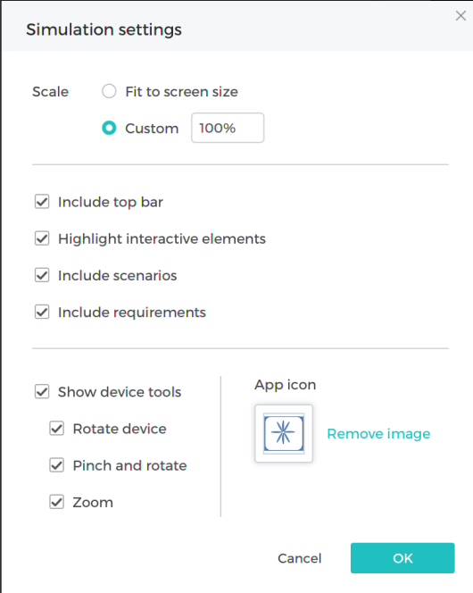

At the moment as a workaround, if you use the Custom option at 100%, the scroll should work.
Hi Ria,
This still does not work. I've attached a sample project that replicates this issue, and a screenshot of my settings. I've followed your guidelines and the scrolling is still broken.

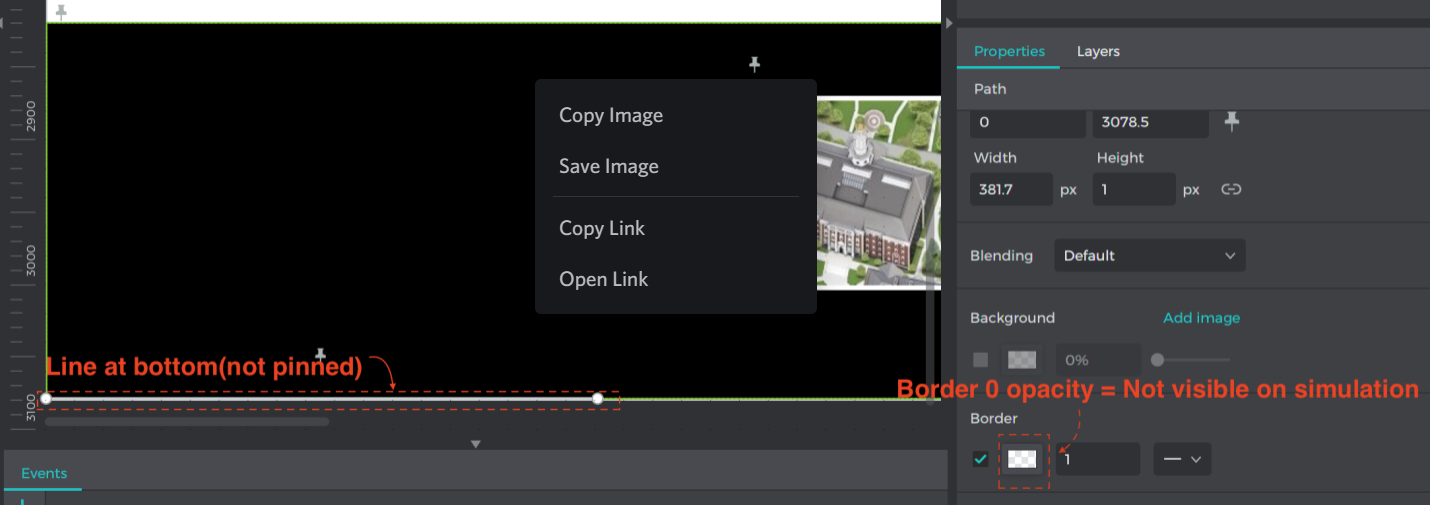

Hello, I'm sorry for the misunderstanding, in your case if all the content is pinned on the screen when simulating, the size of the area is not calculated correctly and then the scroll does not appear. we will be working to solve this problem for future updates. At the moment, as a workaround, you can put some element at the bottom of the Screen and make it not be seen in simulation, I am attaching an image.
Ok, thank you. It looks like putting an element at the bottom of the screen (in this case, my footer) and making it have a 0% opacity border and unpinning it in X and Y works.

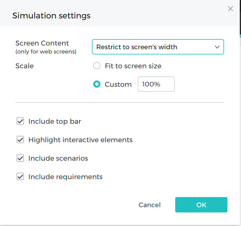

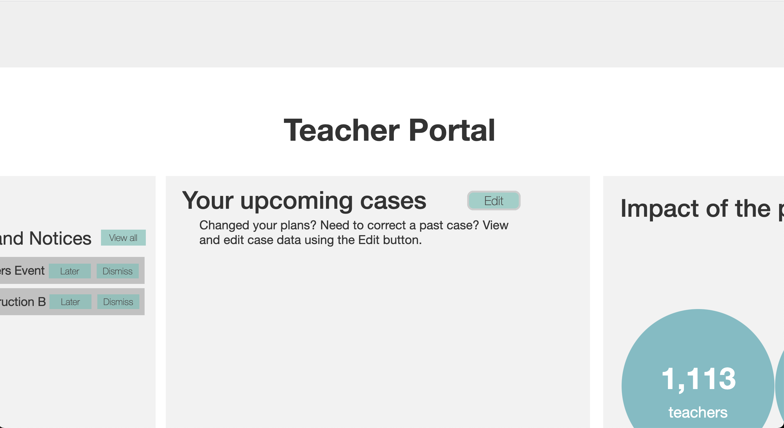

Hi, when I try your solution, it works fine, but now the site doesn't render properly in my laptop's screen. The content is cut off at the sides. It renders fine on an external monitor. When I reset the simulation settings to "Fit to screen size", it fits correctly, but then I cannot scroll. This is the same when I upload the project to the cloud platform. So it seems like I can only choose scrolling or a webpage that fits, not both. If I want both, I'd have to use an external monitor. Is there any way you could advise?
Hello, the solution to this problem was released today with the new update.
