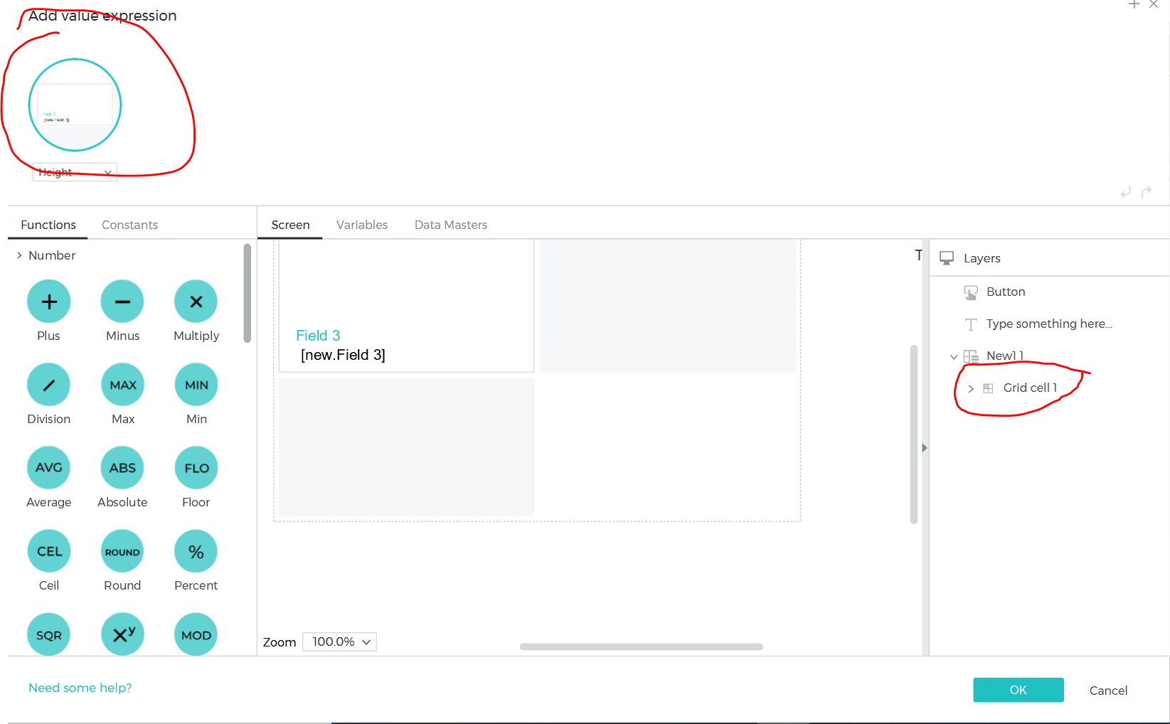

I do the following:
1) select a elements from the screen.
2) Depress the "+" event in the events panel
3) Select a Trigger.
4) Select an action.
5) Choose Set Value to Element.
6) Select a Element or variable.
7) Depress the Calculated radio button.
8) Select Add expression link
9) Drag and drop a Data Grid Cell to the the circle marked "Click to edit or drag and drop component"
10) Select "height" from the pull down choice field.
Is there a particular trigger needed to access the data grid cell height value? How do you access it?

Hi Jeff, we have found a bug that happens only in some cases and we are already working on it, I would need you to try the following:
On the prototype I sent you, select the button and right click on the event to edit it, edit the expression and drag the cell grid (attached image) back into position. click ok twice to finish building and simulate again.
let me know if this works.

Hi Jeff, the bug is found when selecting "height " in the expression builder, it is being worked on for the next update.
As a workaround, once the event is done (which due to the bug will be disassociated from the cell), you have to modify the event, open the expression and drag the cell again. In this way there will be no problem, since you don't have to select in the dropdown (it is already assigned so that it obtains the value of "height").
