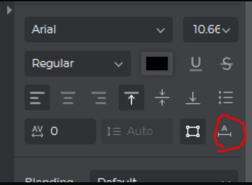

Hello, it is possible that the properties have been modified when updating, no change was made regarding this in the update, so your problem should be solved by selecting the autofit (see the screenshot). Let me know.
Thanks. I figured out that I could change that property, but for some reason it has started reverting back to manual when I copy/past - sometimes. I can change it again and it works as expected. I was just hoping there was some way to stop the behavior. Previously, it always defaulted to the autofit and I never had to change it.

Hello, It all depends on the source text of the copy. Depending on the text widget you are copying, if it is autofit it will be copied with autofit, otherwise it won't. This is the standard behavior. Could you tell me where you are copying the text from?
