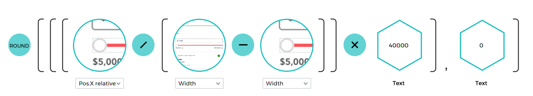

Actually, I need to paraphrase my ask:
1. As you move the slider the amount goes up by a certain amount.
It would be awesome if the amount displayed is rounded to the nearest 1000. So it would be something like $5,000, $6,000, $7,000, and so forth until $40,000.
2. Also it would be nice to have a comma in the formating ie: $40,000 as opposed to just $40000
Thank you Ria
Hello Ivan, we have created an example for you, you can see the events in the new elements,
Let me know if this information is useful to you.

Wow this is exactly what I need. I am looking at how you did it, it's really advance and yet very clever stuff!
I am digesting it right now but I just want to say thank you for your help.
