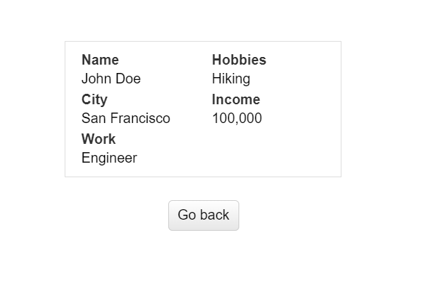

Hi Ria, thank you for your reply. I want to show more details of the user in another screen, when i click "see more" during simulation. I wanted to create similar function for "Example" file the same as "UserInfoData" file. Cause when i click see more in my simulation, it only show the data in the first grid row.

Hi, I have attached the screenshot of what i want to see below.

Hi Ria, I think you have misunderstood my queries. The "UserInfoData" file has what I want to show on my app prototype. During simulation, it is able to show the name selected in the "Search" screen on the "More Info" screen when I click on "See All" button.
However, I am only able to make something like the "Example" file. During simulation, I wish to show only the location details that I have select in the "Location" screen on the "More Info(Location)" screen when I click the "See All" button.
Hello, sorry for the misunderstanding, in the example prototype: on the screen where the information of the variable is reflected, an event is missing. we have added it for you to try.

Hi Ria, thanks for your help. May i know where you added the event and what is added? I can't seem to find the event you have added.
Hello, the event is attached to screen number 2 (select the full screen)

Hi Ria, thank you so much!! I manage to solve it with your help :)
