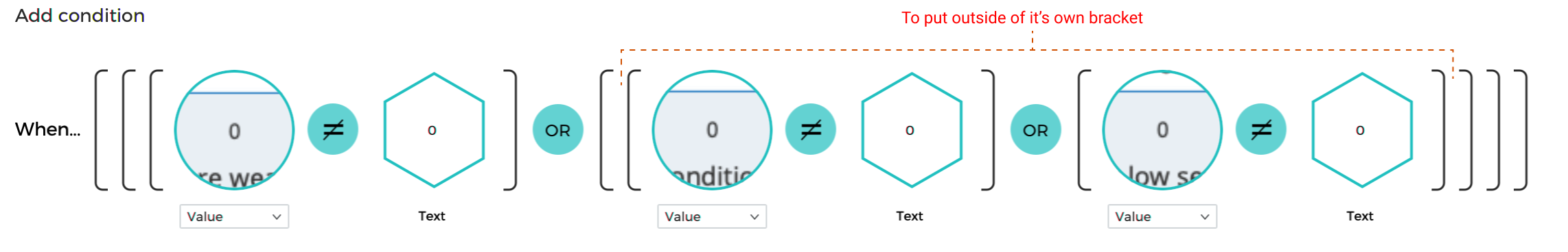

I have a nested OR condition but it seems that it automatically nested 2 of it (refer to attached image). How can I get it to be like:
When.. [ [ Value A = 1] OR [ Value B = 1] OR [ Value C = 1]]

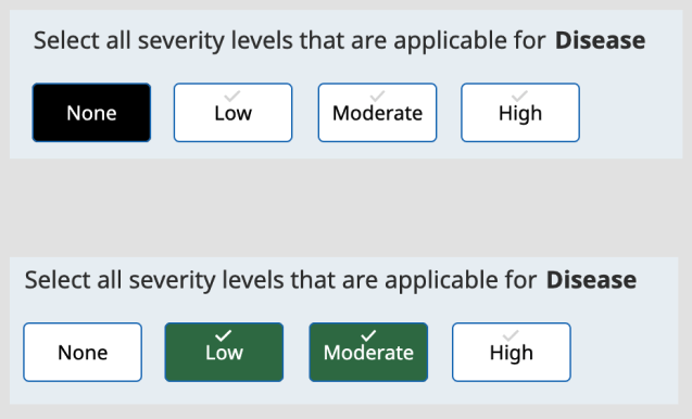

Basically, I would like to do is (refer to image):
If any one of [low] [moderate] [high] button is selected, [None] will be deselected/inactive state. And if all of the button is unselected, then [None] will active state.
Hope my explanation is clear :)

Hi, I think you misunderstood. Or maybe I wasn't being clear.
This is how it should be:
Button 1 is in one group and button 2, 3 and 4 belongs to another group.
By default, button 1 is selected and the rest is unselected.
When either 2,3 OR/AND 4 is selected, 1 is unselected.
When 2, 3 AND 4 is not selected, 1 is selected
When.. [ [ Button2 = selected] OR [ Button3 = selected] OR [ Button4 = selected] ] DO [Button1 = unselected]
Hello! I'm sorry for the misunderstanding, in response to the initial question:
"I have a nested OR condition but it seems that it automatically nested 2 of it (refer to attached image)"
The result is the same. They come out 'nested' because each function can only have two parameters but in the case of three 'or' it is the same if they were at the same level as if there are two 'nested' as the second parameter of the first.
