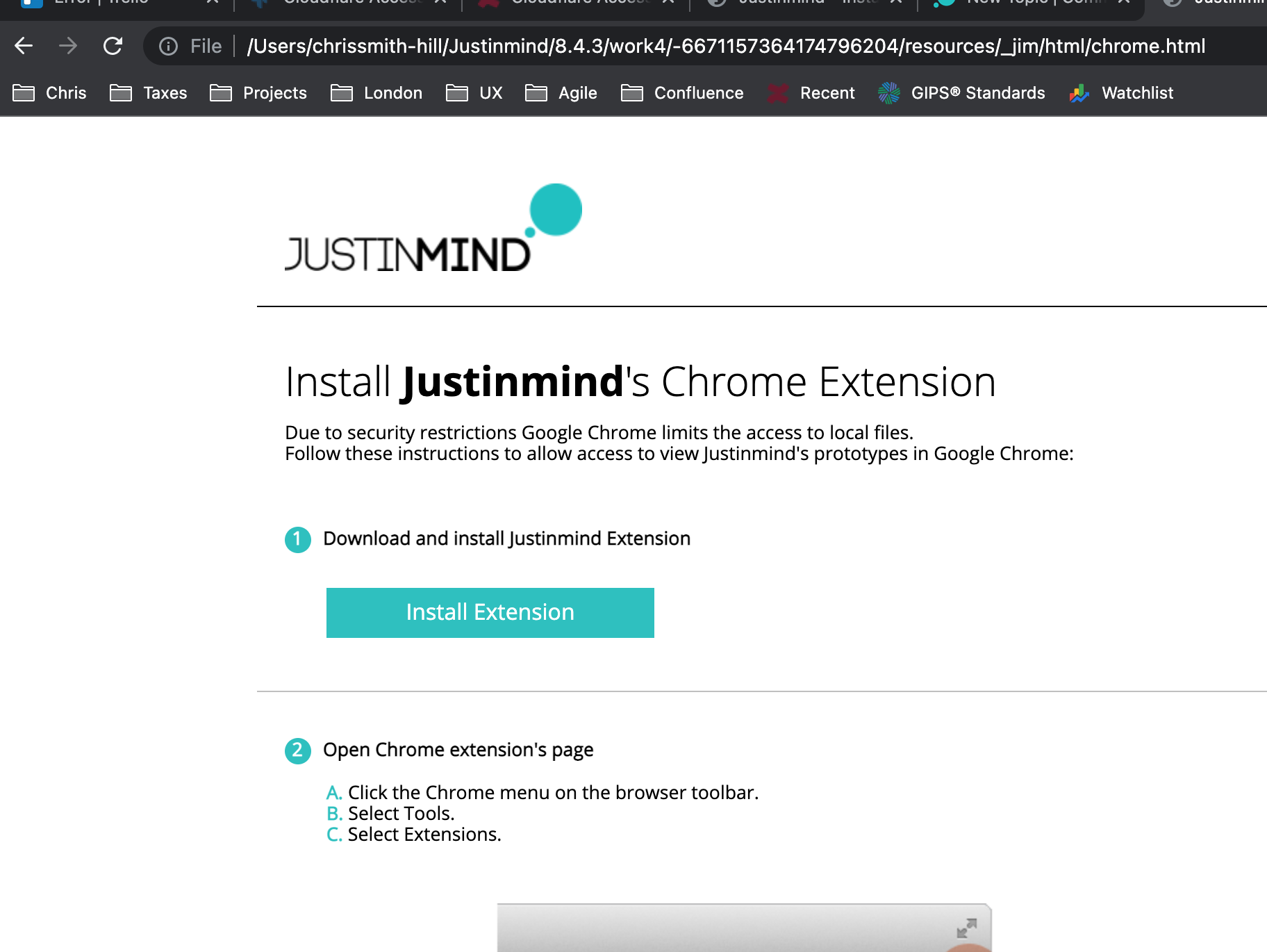

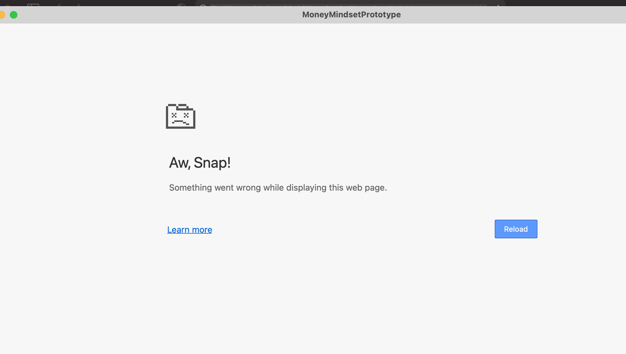

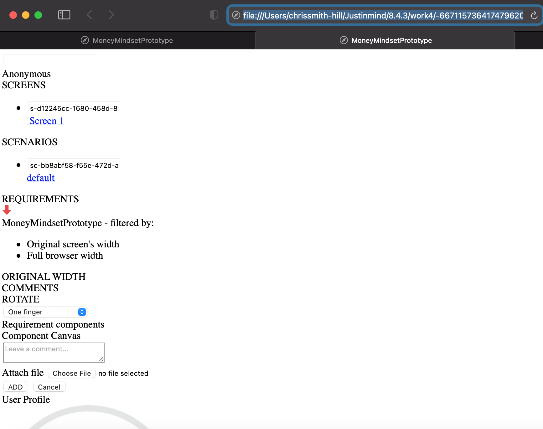

I am using my perpetual license of 8.4.7 and the prototype is not simulating. I've changed the default browser in preferences to Chrome, Safari, and made it blank. Each one is giving issues

The problem is that the browsers have been updated and are no longer compatible with the simulation of versions prior to 8.7. You should install a higher version of Justinmind or an older version of the browsers. But if you have a perpetual license, the workarround for your version would be to post to usernote instead, Posting to usernote does work with your version.
