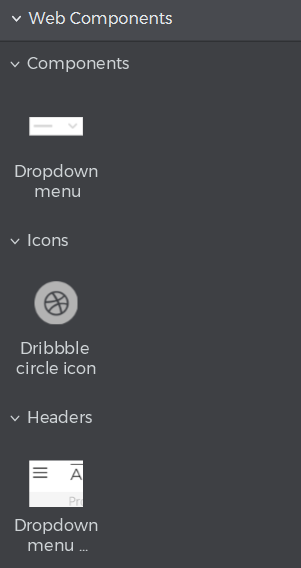

I am looking for common web controls, like an expander, that don't seem to be available in any web kits. I'd rather not have to build all of these from scratch and would like to know where I can get additional controls that are not in the web kits.
Hi Todd, could it be that it is useful to you, some menu within web components?
if not, could you give me an example of what you want to prototype?
Hi, Ria. Thanks for your response. I was looking for an expander. These are commonly used for FAQs. Here are a couple of examples.

A lot of people use the up/down or right/down carot images on the left, too. I'm just finding that this prototyping tool has a huge learning curve and it takes a lot of time to put together a prototype. Maybe it's just me.
