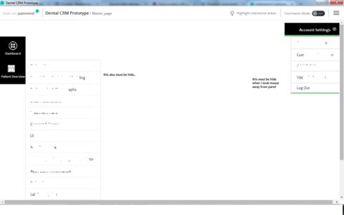

hi
with the reference of this tutorial http://www.justinmind.com/support/cus...
i have a menu one is account settings and second is patient overview.. and in account settings there is panel (dynamic panel 1) with different sub menus and same condition i set with patient overview.. i also add event " on mouse enter" on account settings and the select ( dynamic panel 1) after this i select dynamic panel 1 and add event event " on ,mouse leave"for hide menu .. same i doing with patient overview menu...
but when i drag mouse on account setting panel open but when i took mouse away from dynamic panel then dynamic panel not hide.. and after this when i drag mouse on patient overview menu open but not hide..
CHeck image
