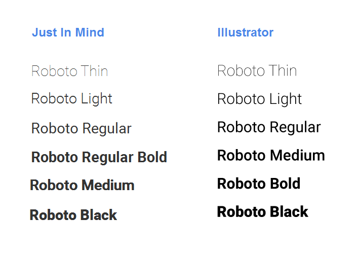

So an update just came out and the Roboto rendering issue has not been fixed.
Please look at the attached image. You can see how Illustrator renders each heavier face in the family in a nice even fashion as you would expect. However, in JustinMind the Medium face renders as heavier than bold or black... the all-important hierarchy is rendered useless. Roboto is the primary font that our platform uses and "medium" is the primary thicker font face we use... except i have to use bold instead... and Medium is not useful at all. And using Bold in place of Medium means I cannot use Bold at all.
This is something that needs to be fixed.
Agreed. The characters look correct, but the weights are off.

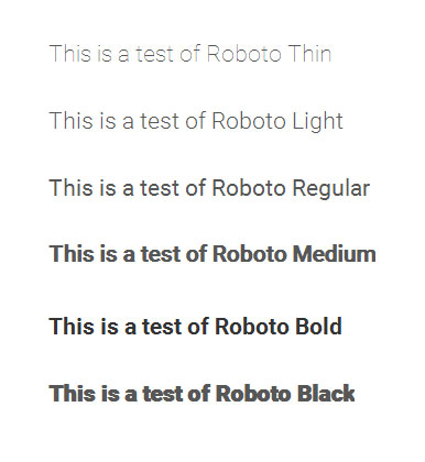

Already had Roboto downloaded from Google but for the heck of it I uninstalled and reinstalled it and did the test in JIM and it still looks incorrect. I've attached a screenshot of what I was just seeing in the editor... which looks the same as the 1st one I attached. The weight hierarchy is incorrect and some of the weights also seem to be getting squashed downward somewhat... it's very obvious on Regular weight... all the o's look like circles instead of ovals.

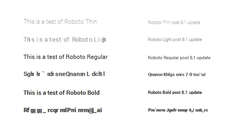

I updated the editor and checked and now I'm not only having the issue where the Roboto weights are incorrect now I'm also seeing the garbled text that was supposedly fixed in 8.1
I've attached another image so you can see what I am seeing.

Sonia,
I just opened a prototype on my home laptop. It was at 8.0. It was able to display Roboto Light normally. Although I WAS still having the aforementioned font weights issue where Medium was heavier than bold I wasn't having a problem displaying the characters themselves.
So I just updated the prototype to 8.0.1 and now all the characters are garbled, just like on my work laptop (which also had no problem until I upgraded to 8.0.1 and now displays completely garbled characters in the editor as well)
I tried uninstalling Roboto, restarting my laptop, reinstalling Roboto, and reloading the prototype... still the same result.
In the editor the characters look like Gaelic when I'm typing and when not selected they just look all jumbled and overlapping.
In the simulation everything looks normal.

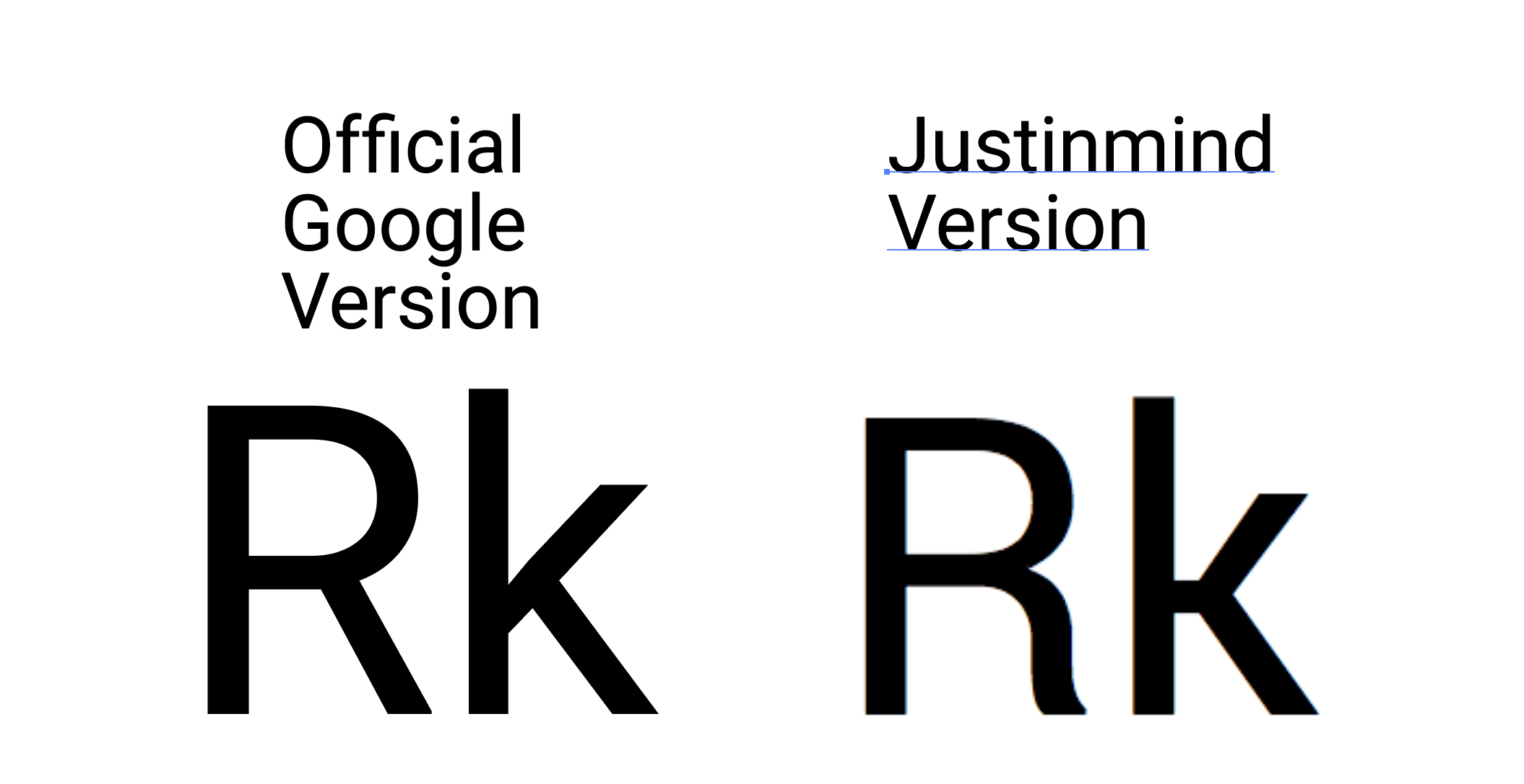

1. No java folder. Just C:\Program Files (x86)\Justinmind\Justinmind Prototyper [version] and Fonts folder.
2. Roboto fonts do not appear visible in my Windows font folder. This is apparently a known problem with no obvious solution in Windows 10. And I've tried a variety of approaches folks in Windows forums suggested. That means I cannot delete the old version and without doing this, adding your absurd "special" version of Roboto is not possible. i've now spent over an hour on this issue. 30 more minutes and I'll find another tool. This is absurd. Why can't you just use the standard Google font like every other tool. Roboto is the most used font on the planet for web and mobile dev.

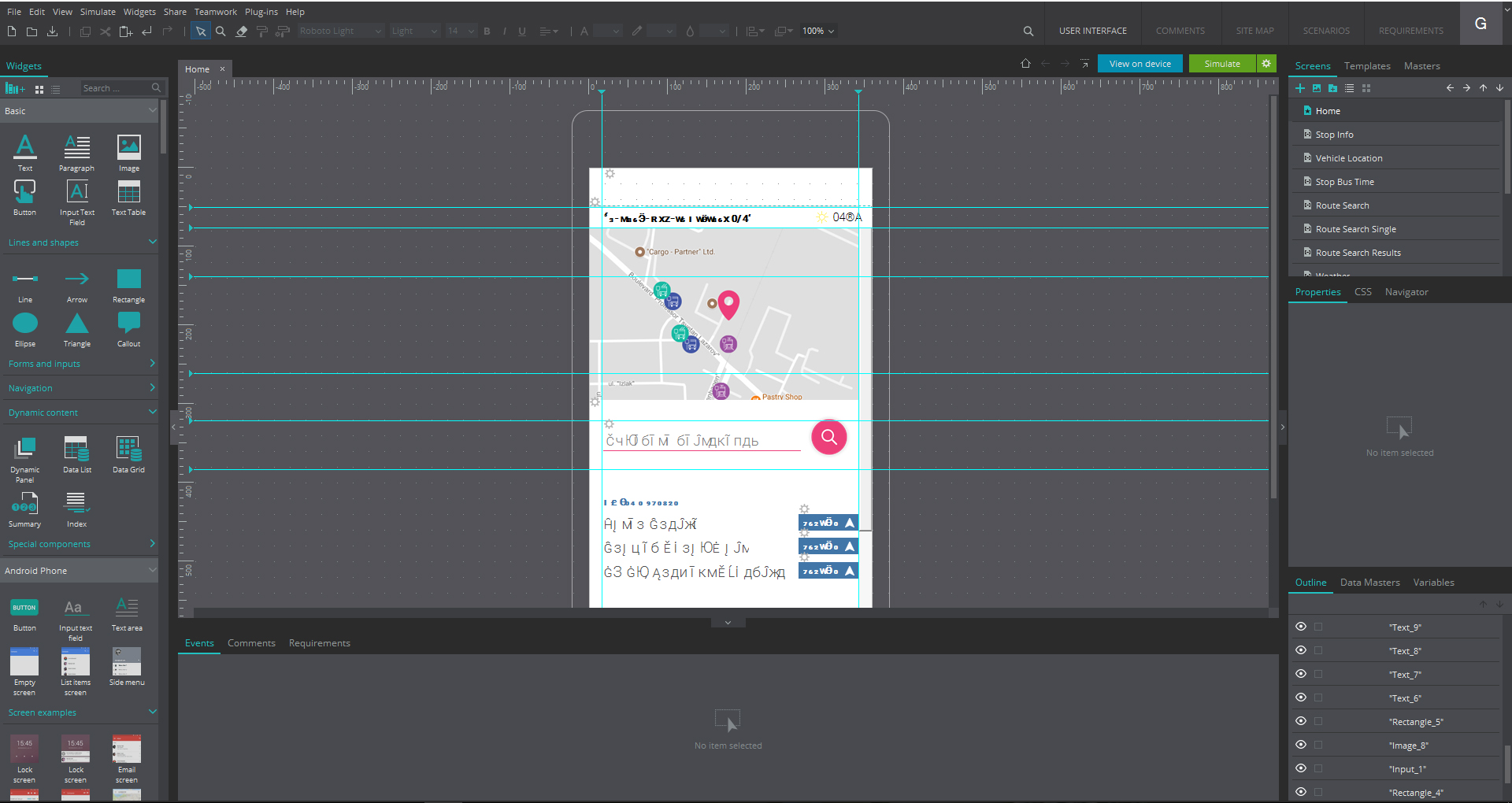

Okay, the fonts render correctly simulation mode. But not in the editor. FWIW.
