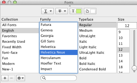

It loads correctly in Omnigraffle and Pages, but in those applications I can adjust fonts using the font window. c657adc69daaff2f7e22b49594280d54
Yes, I think that's the problem. Instead of using a native font dialog we display all the fonts in a drop down menu. The thing with Helvetica Neue is that Condensed is an style inside the font (like bold, or italic), not a separated font. So it's not listed in the drop down. Sorry for that. I'm afraid we'll need to change that drop down for a native font dialog in future versions.
