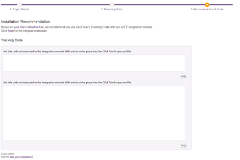

We are working on a prototype and wish to test it with a targeted population, but we wish to have certain statistics like the time spend on each page, the clicks on each page, etc. We saw that the usability testing tool clicktale some of these statistic tools but we failed in tryng it. It seems like the usernote interface ask us to provide a "top part of the integration code provided by clicktale" and the "bottom part of the integration code provided by clicktale", but we find no code at all in clicktale and clicktale gives no possibility to upload our prototype (we tried to just analyze the prototype in clicktale with the link given by usernote, but clicktale say that this link is note valuable)...

Hi Nicolas,
1. Log with your account.
2. In project details, set www.justinmind.com as your URL site, and if it's the free account select the http:// option instead of https://
3. Check the option Dynamic elements/JavaScript and set JAVA as the architecture script.
4. The third step will give you the top part and the bottom part that you have to paste in usernote.
