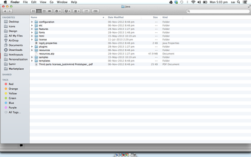

Can you send us a screenshot of directory "/Applications/Prototyper Pro/Contents/Resources/Java/" in list view with the size of archives visible?
Here's the screenshot: 8f6c3665f3dcb5782d64b1638a071b5d
Seems that some files have not been properly installed after the update and that is the cause of your problems.
Prototyper needs a minimum of 200Mb of free space in your disk to be updated. Can you check that you have more than 200Mb of free space in your disk drive where you have installed Prototyper?
