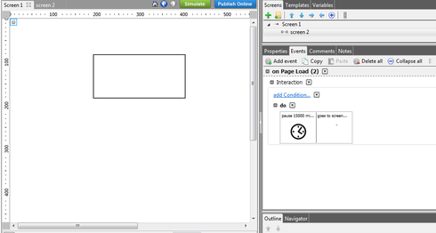

Here's what you should do.
1. Place the loading bar on one screen
2. Add on Page Load event -> Pause -> 15000 milliseconds
3. On the same event add link to next screen 55ea00410d81dd778b46499de4b5003a
Thanks! this worked! Although the progress bar isn't simulated but for my prototype, this works.

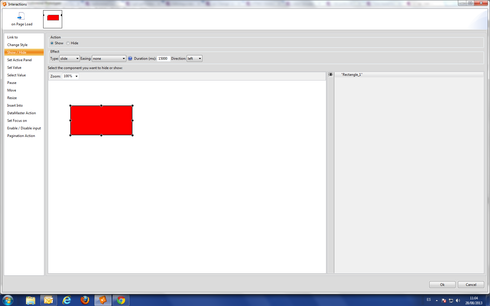

to simulate the progress bar, you can do the following.
1. hide the rectangle by default
2. on page load event -> show rectangle
3. Effect (slide) Duration 15000 (ms) direction (left) 5bbbb76c7ef25aef24221e8a8d8fd0d5
