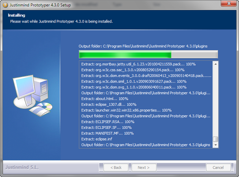

Hey guys. I would like to trial Justinmind as it looks like a potential replacement of Axure, which we are using at the minute. Unfortunately, the installer of the demo version crashes and I cannot install it... Is there any trick that I should perform to make it work? It crashes when I am installing it as an administrator on Windows 7 32bit. The point of crash is always at the creation of 'Output folder: C:Program FilesJustinmindJustinmind Prototyper 4.3.0plugins'. After killing the crashed installer process, I can see all the files copied to the new directory but, when I want to execute JustinmindPrototyper.exe, all I am getting is an error message 'The JustinmindPrototyper executable launcher was unable to locate its companion shared library'. Removing the directory and reinstalling it again doesn't help. Please advise! Thanks :) ece47abb33fccc99616b18c7b584937d

Hello Wojtek,
It appears that the installer hanged while uncompressing some files. We have recently noticed that some antivirus like ‘Symantec’ or ‘PC Tools’ block that process and the installer cannot finish properly. Could you please tell us if you are using any of these applications or any other antivirus software?
Meanwhile you can try an already uncompressed installer. Please contact jim.support@justinmind.com for more information.

I am, in fact, using ESET Antivirus. I will try disabling it for a couple of minutes... ;) I will give you a shout how it goes! Cheers, Wojtek
Well, disabling ESET didn't help. I'll email Jim for the uncompressed installer. Thanks!

Having the same/similar issues, however I have downloaded the latest version, and tried previous issue solutions and still no joy in getting the trial installed - so as this is the most recent install issue created, seemed a good place.
ive tried the following
1. 4.4.1 hangs on the plugins install - un-installed (deleted files/folder) and reinstalled numerous times no joy
2. installed 4.3 - installed but then on load i get 'failed to start java virtual machine'
3. went back to a 4.2 install same issue
4. also all the uncompressed installer versions have the same issue as 2 & 3

Could you try with this installer instead http://justinmind.s3.amazonaws.com/Ju... ?
Wohoo! I've installed this without issues! Let's see how it works...
Then there is some application of yours blocking one of the steps of the installer, probably an antivirus or a firewall of some kind.
