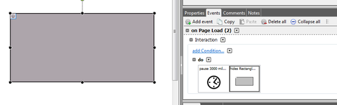

Is is possible to have a pop up window time out, so it could be used to communicate transient feedback?
Comments (2)
If you download our YUI widget library, you will find Download Progress Bar widget.
http://justinmind.com/prototyper/widg...
For the pop up window time out, you can add 'on Page Load' event to your window that pauses, for instance 3000 milliseconds, and then hides. 5a03fe3a3fc55dd46066d4ff0a1ea740
