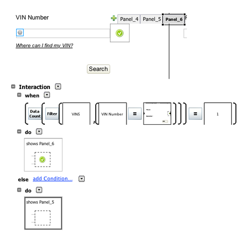

I want to be able to change an image as the user is typing. So as you can see in the image...it is set up so that if they enter the correct text as per the data master - then the tick will appear (dynamic panel 6) and if they don't enter correctly then cross will appear (dynamic panel 5)..
however for this to happen they have to click outside the text field - where i want it to change to either tick or cross on completion of typing it so they know if its right without clicking outside the input field. .is this possible?

Hello Annabelle,
You can try with a 'on Key Pressed' event defined on the input. The only problem is that you will have to check if its value changed storing it in a variable. I hope it works for you.
