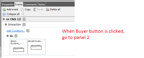

Look at the screen shots below. Let me know if you have any questions. I can also send you the .vp file. Just send a request to 73588a8dc681c2d67fda57d9e95cc5a5
Just for clarification on the above screen shots.
Here's how I did it.
1. I placed two radio buttons into canvas and grouped them together.
2. Placed labels 'Supplier' and 'Buyer' next to them
3. Placed a dynamic panel with two panels. Panel 1 says 'Supplier button selected' while panel 2 says 'Buyer' button selected.
4. Place 'Enter Company Email', input box, submit button, and label 'Error! You entered incorrect email.'
5. Lastly, I added the conditions above
