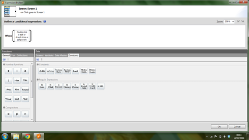

I don't see the "Window width" option under Functions in the Expressions Builder. What am I missing?
Hi David,
"window width" is a constant. You have to click on the tab "constant" 37fd6f39af2791fcb78a05c7bb8569d4
