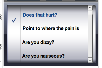

I'm trying to make a picker that looks functional on an iPhone webbap prototype.
(the widget is the standard iOS interface item that looks sort of like a tumbler on a one armed bandit).
The picker that came in the iPhone widgets library only has 5 items in it and doesn't scroll very far.
Is there a way to add more items to it? Can i make the items buttons that change another part of the screen? I am trying to mockup a picker of phrases that I can scroll through, and when I select one it plays a video in the player window above it.
See this link:
http://www.justinmind.com/usernote/te...
Alternatively, has anyone made a picker widget with more items that they can share?
Thank you. Any help is very appreciated! 2312a8a546dd195de8bf73e9568ee395
Comments (2)
Just make the dynamic panel that holds the values (the one with the scroll, it's easier to select it through the outline view), make it longer and copy/paste values, then assign events to each values (links for instance) and make the dynamic panel as high as it was before.
A simple Select List (from Widgets) , in the prototype, converts to a scrolling wheel when viewed on an iPhone.
