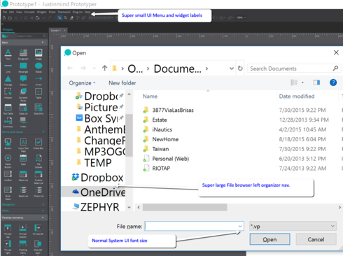

Justinmind 6.8 UI Font size way too small on Windows 10 (had same problem with Windows 8, 8.1 on earlier versions of JIM)... using latest Java version (uninstalled all prior versions) - and uninstalled and reinstalled 6.8 clean. 24e21ac8f139db13178fc39e8e26350a
Please contact jim.support at justinmind.com and ask for a HiDPI installer. It's still under test but it might help you.
