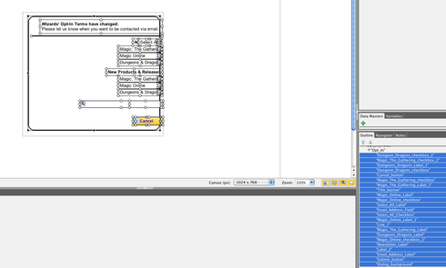

I was able to replicate the previous issue. I am using Mac OS X.
See "Before selection" for screen cap of order of items before I selected them.
1) Using the Outline panel, Shift-Select many items (in this case they were within one panel of a Dynamic Panel).
2) Drag items to another location.
3) Selected items reverse order within Outline panel.
See "After_Select_Move" to see new order. Because the "Dialog_background" item has a white background, the items appear to disappear on the Canvas.
Note: When I try to replicate this issue without a Dynamic Panel, I cannot do so. This issue appears to be related to dragging many items into and out of a Dynamic Panel.
