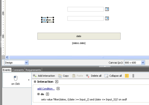

96a11e995c48dafe6e3b1ea115adfd91
Oh sorry sorry! I didn't see it! You are configuring a condition but what you must configure is a set value event with a calculated value. The calculated value expression must be the filter one.
Wow great it work ! Victor I must say great customer service really appreciate it !!!
