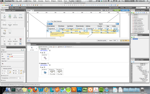

Here's a screenshot to show how I have things set up. Like I said the save icon on the add-row table has the datamaster New to customers, with all of the inputs mapped correctly. And then on click it sets value to the table, the datamaster, and also makes the row disappear.
The issue I've been having is I put Set Value to the datamaster it saves things correctly and upon hitting refresh in my browser I see the new value added, but if I have it set to set value to the table in the prototype it just refreshes and the table goes blank. Everything else works but for some reason my set value is messed up. Or maybe the New datamaster action. Thanks! 8618959038579fa52752da68913a102a
In fact you only need two actions instead of three, the "New data master instance" action that adds the new data on the data master and the set value action on the table to refresh its contents.
The third action you are using to set the value on the data master is not necessary this is made by the "New datamaster instance" action. In fact a data master can't be the target of a "Set Value" action, so you should be setting the value on a variable with the same name of your data master("Customers").
However, your prototype should work well with the actions defined. I'm not able to find the problem by looking at your picture, if you don't mind you can send your prototype(".vp" file) to jim.support@justinmind.com so we can figure out what could be happening.
Ok, just sent it. Thanks for your help. I thought it seemed set up right, so I was confused as to why it wasn't working too.
After checking your prototype I found that the “Set value” action doesn’t have any value assigned, that’s why the table is emptied after the user clicks the button. You’ll need to set the “data master” as the value of the action. To do this modify the action following these three steps:
1.Click on calculated value
2.Activate the “Data Masters” tab on the data section.
3.Drag & drop the Customers data master to the expression that will be assigned as the value of the “Set value” action.
4.Click Ok to close the expression builder, and Ok again to modify the action.
