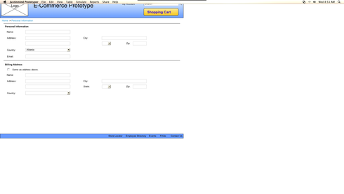

Attached are some screen caps. Note the Justinmind menu on top on one and not the other. It seems to toggle back-and-forth for not apparent reason. I could not replicate the Safari menu on the top, but I have seen it a number of times.
If it helps, I am using Mac OSX with a double monitor. bcf51426aaa5673d43fb31d31b6c5fc2
We know about some other users who are having problems with dual monitors on Mac too.
