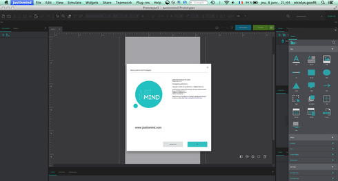

I do not understand why it is still not fixed while I have the 6.3.1 ?
Please help !
