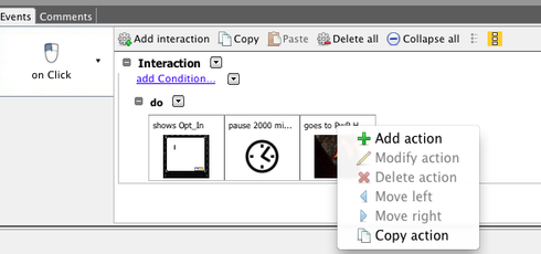

Unless I am doing something wrong, I think that I have found an intermittent bug. When I right-click an individual action in the Event panel in Mac OS, many of the menu options are disabled (see screen capture). This make it impossible to delete, modify or move an action.
I have noticed a pattern, that when I am working within Justinmind only, the menu displays incorrectly. When change to another application by clicking outside Justinmind, my first attempt at opening the right-click menu displays it correctly. But then in all subsequent attempts, it displays incorrectly.

It looks like the right click didn't selected the action. If you take a closer look you'll see that the action doesn't display the 'grey border'.
